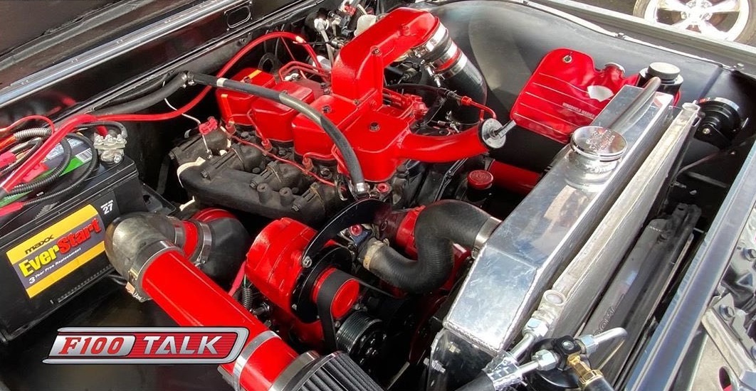

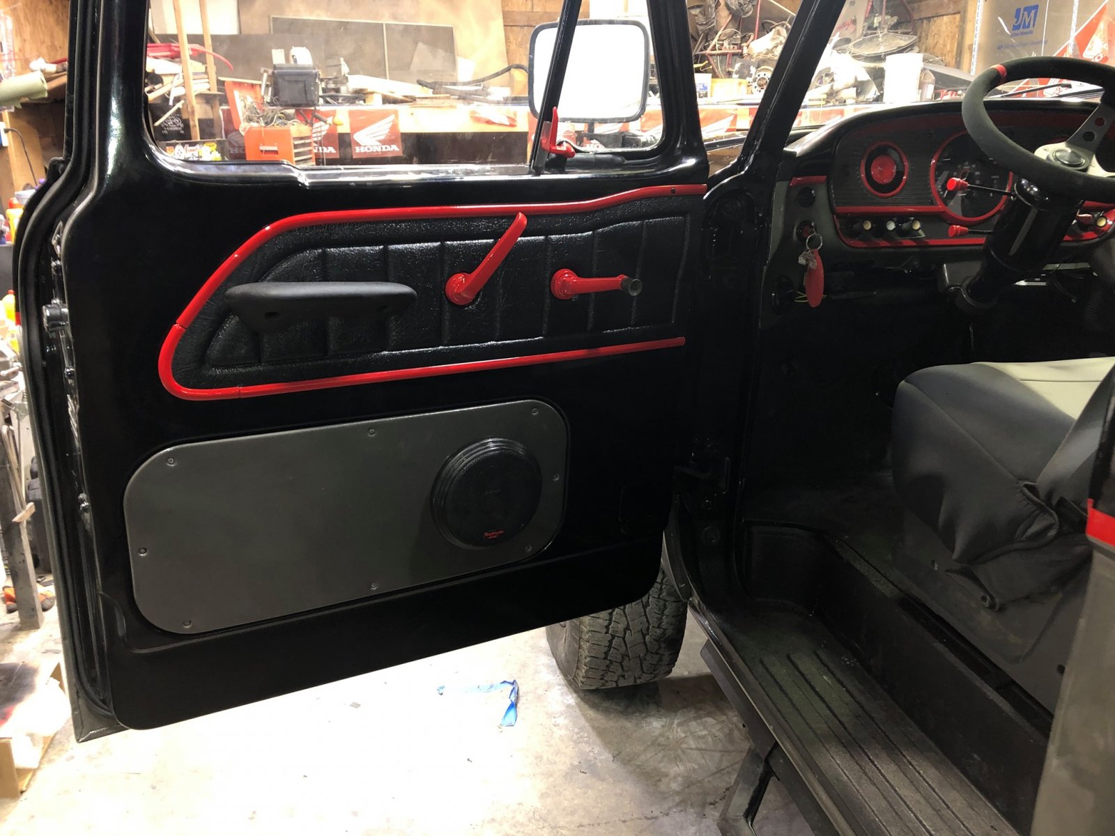

Finally just about finished with the build of the truck.Was a 4BTA. VE pump, I think I turned it up a turn, (been over a year since motor build part was completed, but only ran a few times), pump rocked over towards head to advance fuel,5x12 injectors, HW30X, governor spring, aftermarket fuel pin... It smokes slightly at idle, but when blipping throttle with no load or boost, it smokes up the shop real quick. Under load/boost on the road, doesn't smoke much. What adjustment to the pump do I need to make?
