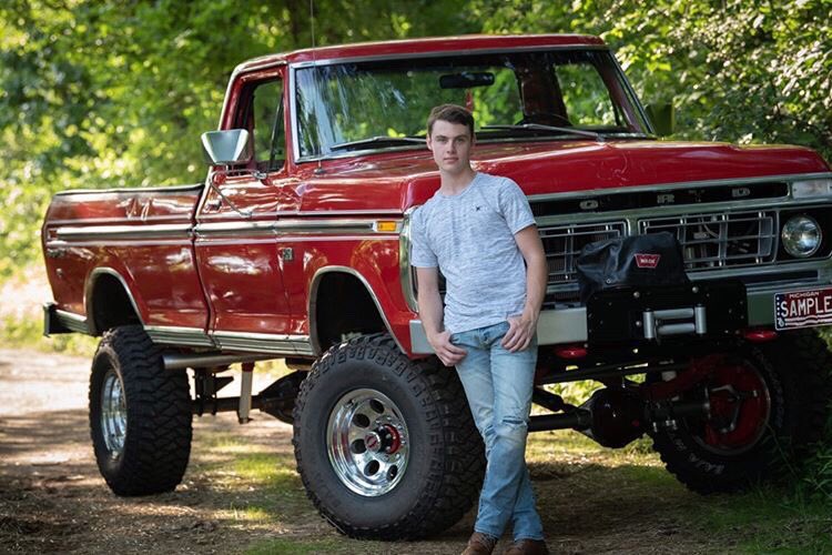

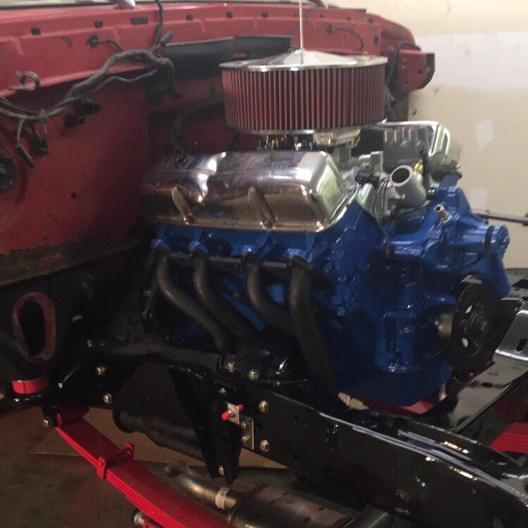

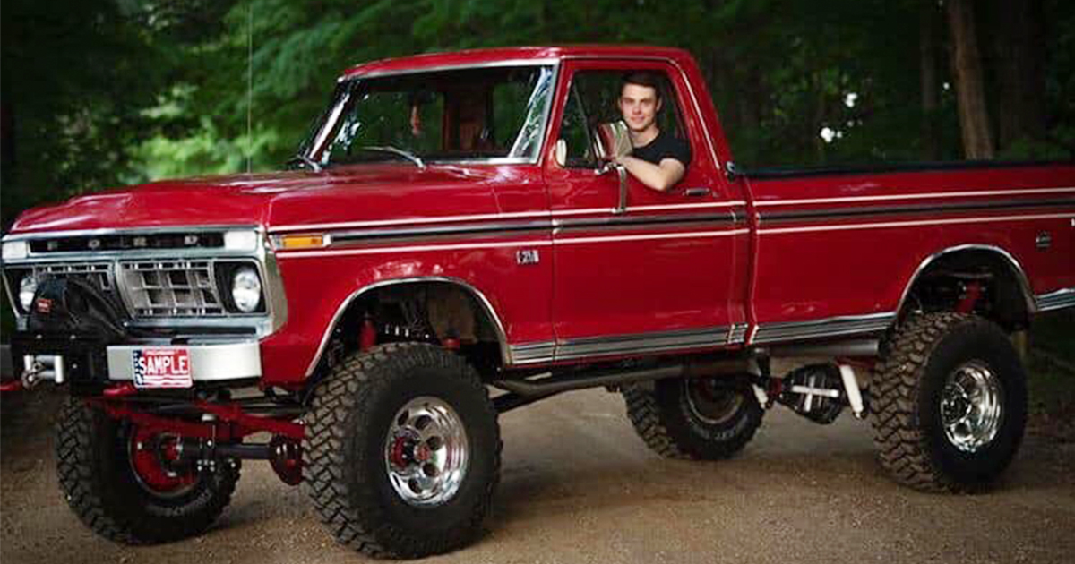

Logan Dilts says: My truck is a 1976 Ford F-250 “Highboy” with a 416 Ci ford FE engine, I started building the truck when I was 16. Following the engine is a C6 auto trans and a divorced np203 transfer case converted to part time.Owner https://www.instagram.com/logandilts43

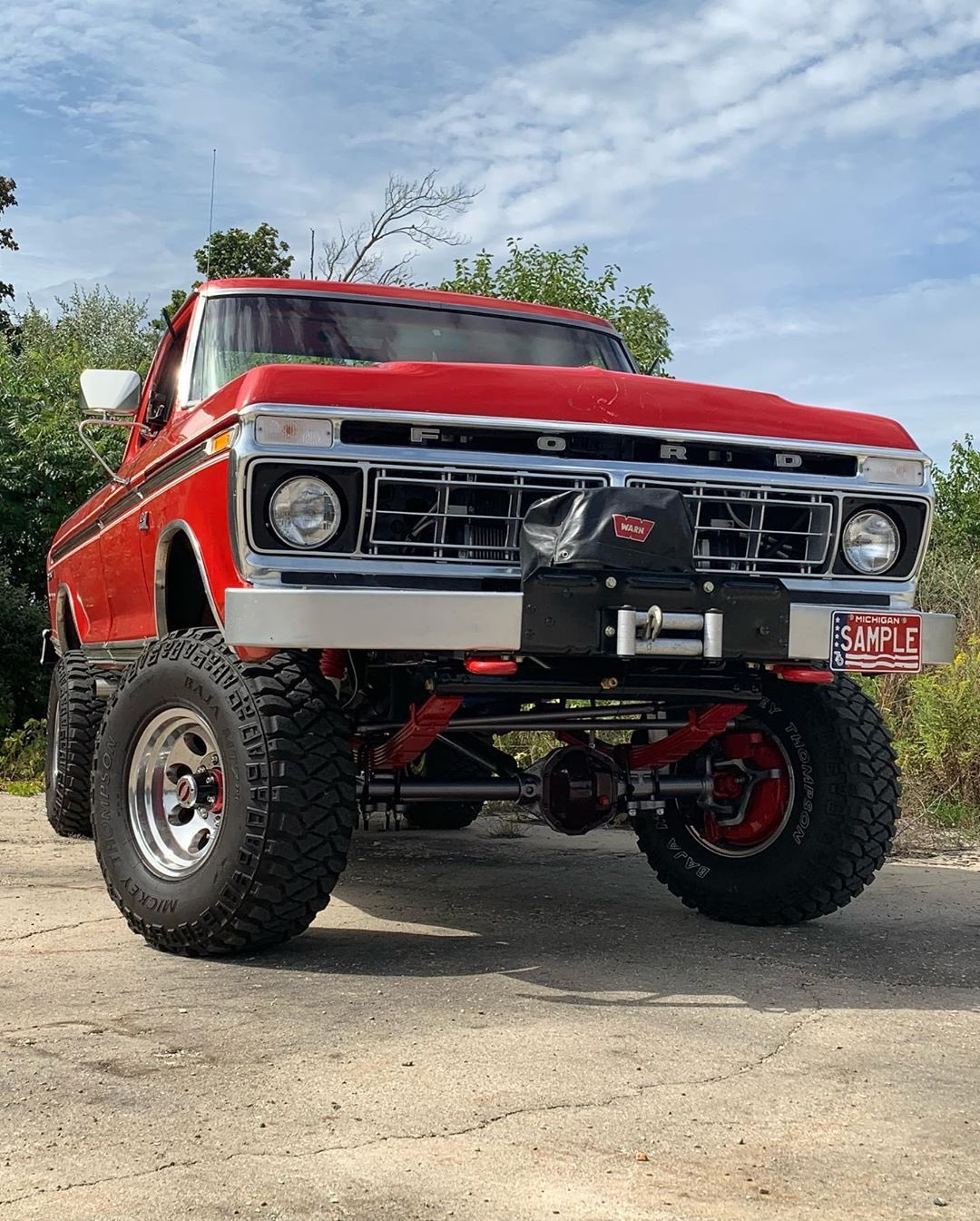

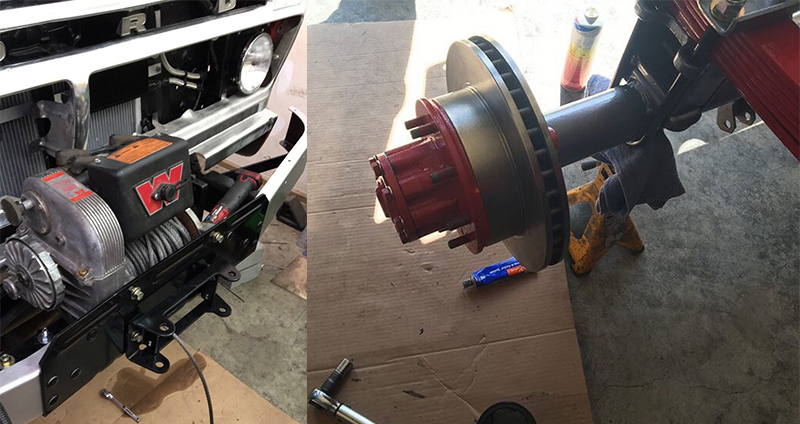

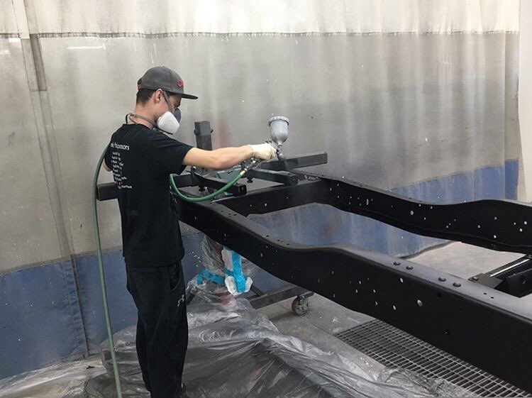

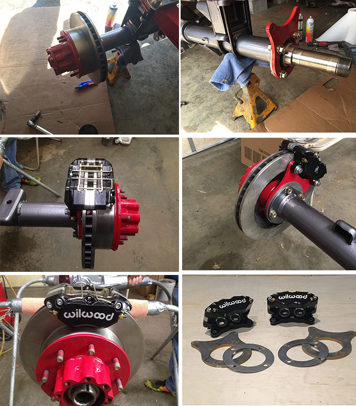

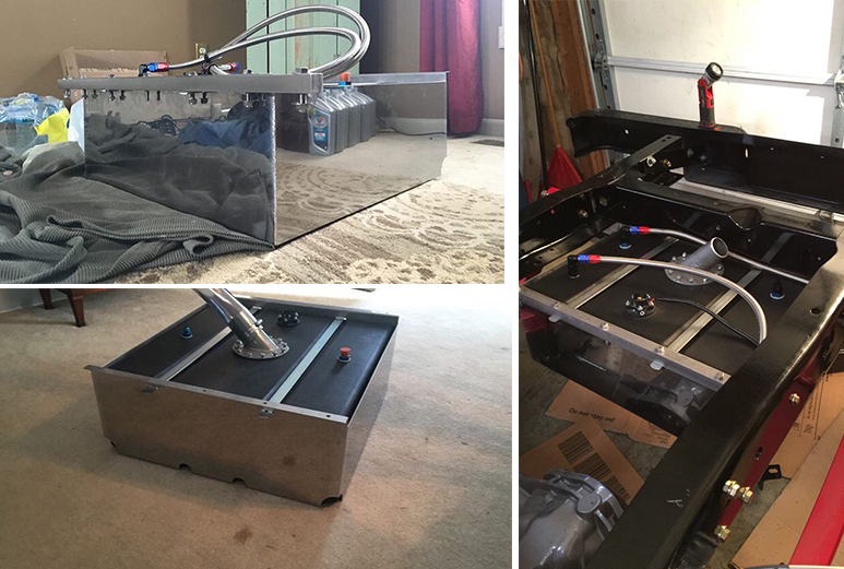

The truck has a custom Wilwood disk brake conversion designed by me for a Dana 60 rear It also has a custom stainless steal fuel cell tub as from factory there was no fuel tank under the box.

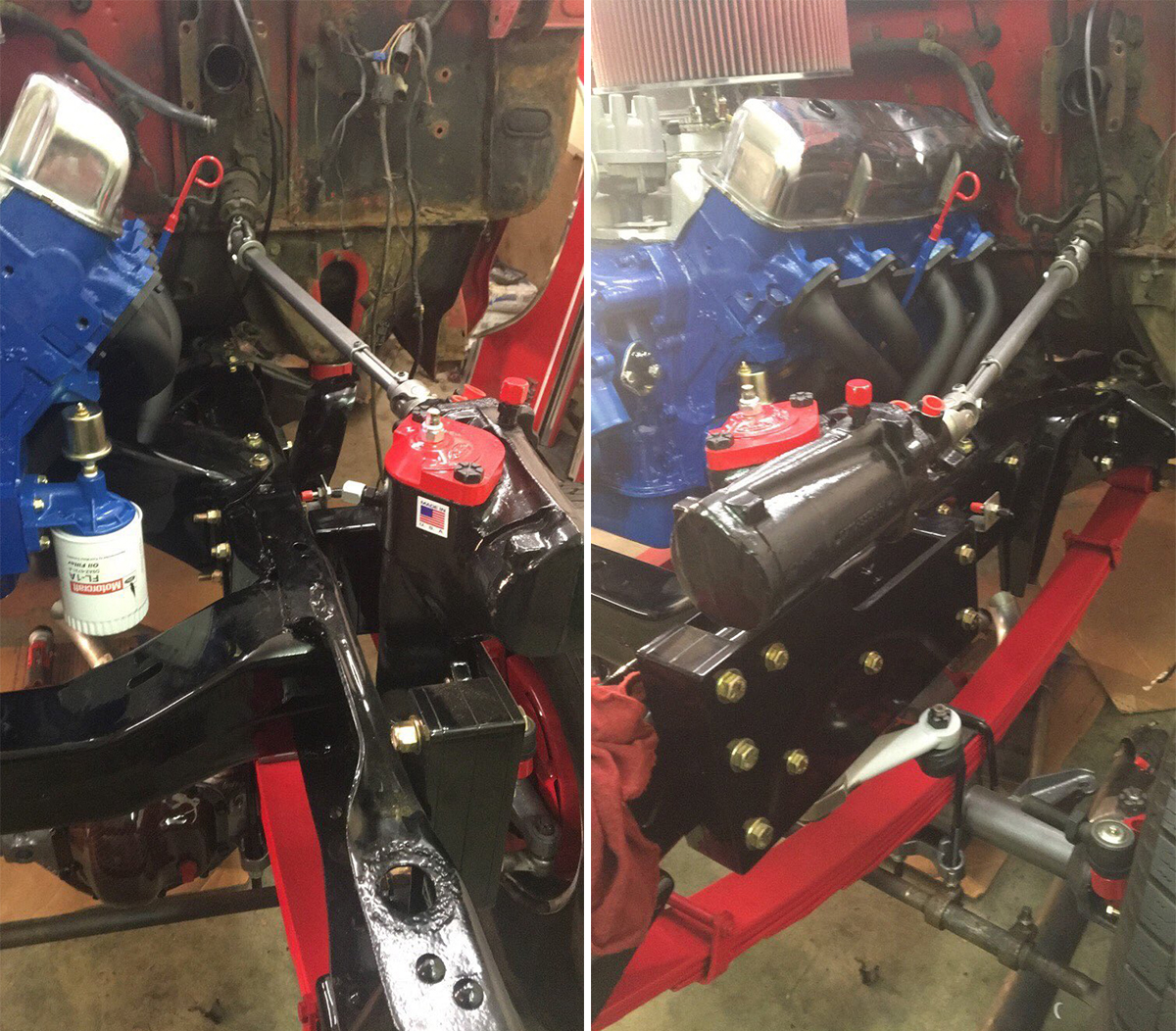

These trucks originally had power assist. I also designed a full power steering system so it is no longer assist. It has a high steer crossover setup so there is practically 0 bump steer. 16x10 Mickey Thompson Classic III rims with 35x12 Mickey Thompson Baja MTZ P3 tires and a 4in Skyjacker lift kit.

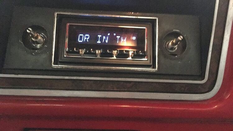

There is a Retrosound Long Beach radio in the cab that feeds a 5 channel Pioneer amplifier. The amplifier feeds two pioneer 6x9, a 12in shallow pioneer sub,and two alpine door speakers.
