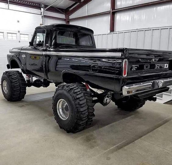

1966 FORD F-100 1 TON SHOW TRUCK WITH 650HP
Tomorrow, 00:35

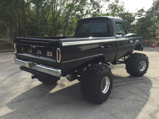

1966 Ford F-350 F100 XLT RANGER 1 TON 4X4 4WD F-350 CHASSIS

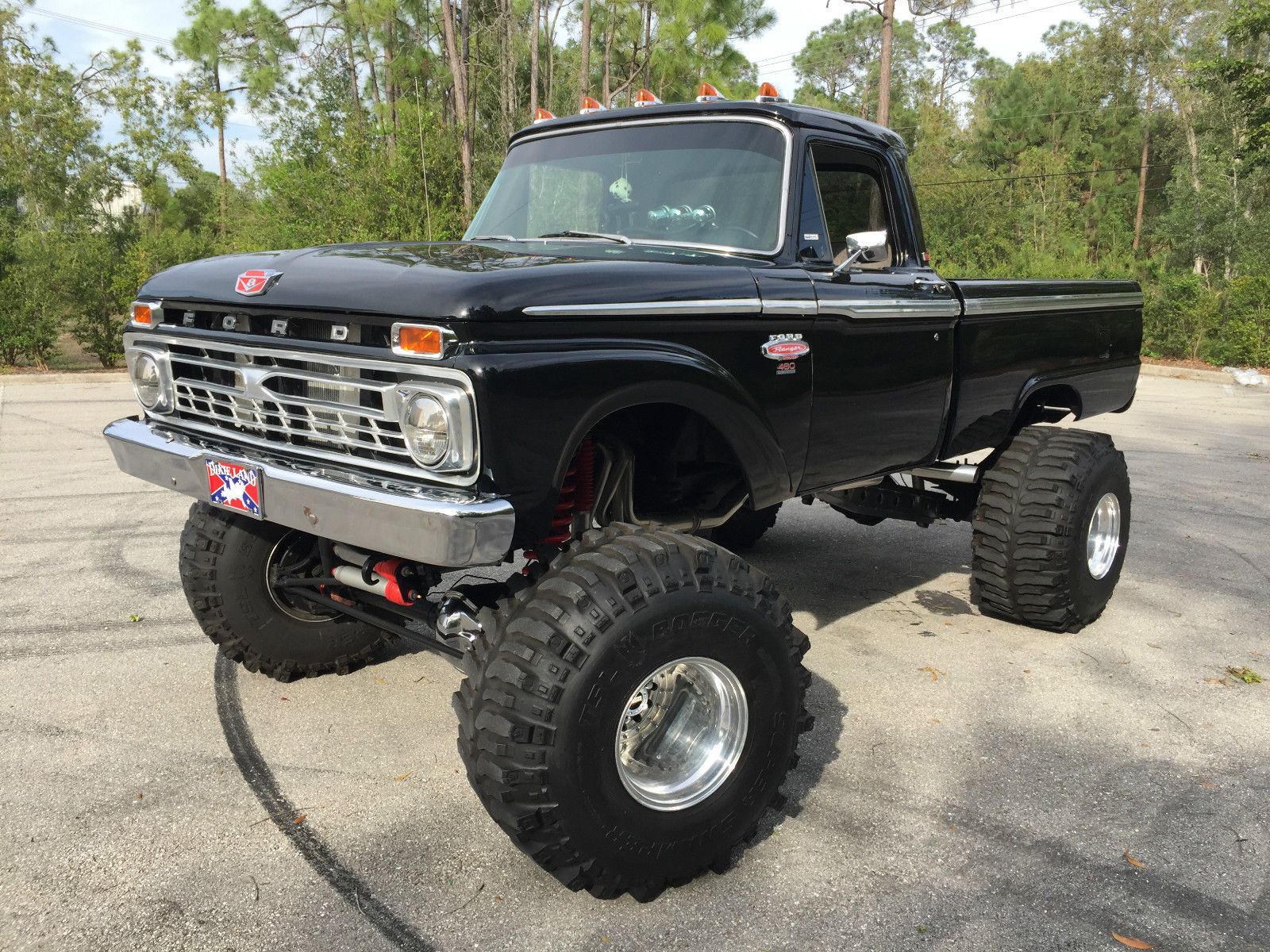

Built locally here in SWFL, this incredible truck started with a ground-up built chassis that came from a 1979 FORD F-350 1-ton pickup truck. The body was removed and scrapped, and then the frame was stripped bare, cleaned, de-tabbed, and treated to rust preventative and clean black paint.

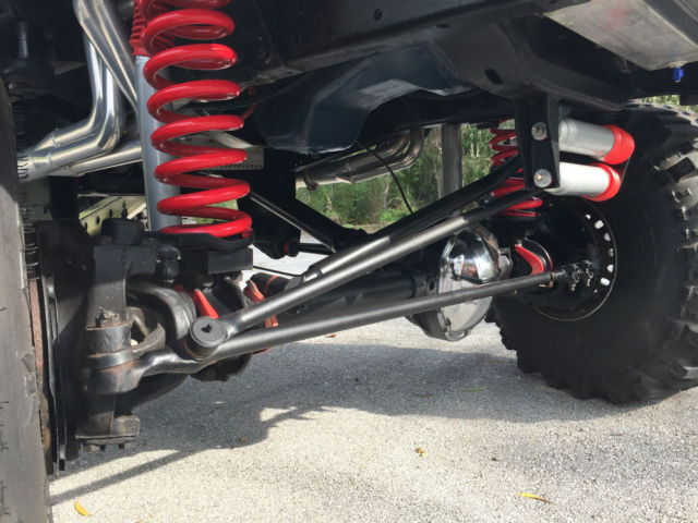

The front is a DANA 60 that was completely rebuilt using YUKON parts and new splines, which also went into the rear DANA 70.
An NP205 transfer case activates the 4wd, which works as it should in low and high.

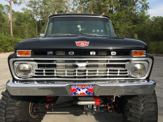

Front leaf springs were ditched in favor of shocks and coils, while the rear gets shocks with leafs, and the truck has a surprisingly nice ride on the highway with more than enough travel and flex for having fun too.
Steering was all rebuilt and the stabilizers and power assist make it so easy to steer and handle that your Grandma could drive it.
Custom fabricated aluminum ladder bars look great and work great too, and the chrome covers dress the front and rear pumpkins nicely.

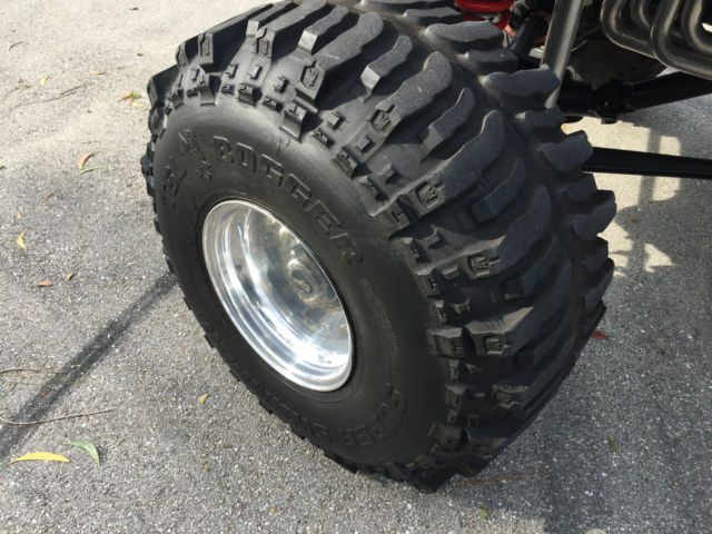

It rolls on 15x8 WELD show-polished aluminum wheels wrapped in SUPER SWAMPER TSL BOGGER tires, size 18x39.5x15LT, which will pretty much roll over anything that gets in your way.

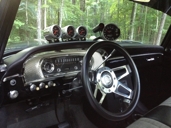

All new electrical systems were put in place and a complete custom 1,000 watt audio system was installed by CarTUNES in Ft Myers, FL with a bevy of hidden speakers and visible ones, and two massive 12” subs in a custom enclosure behind the seat where the gas tank used to live.
It sounds INCREDIBLE, and I felt like Johnny Cash was sitting next to me cruising around with the radio on! It has a ton of extra functions on the deck, and appears to be IPOD, USB, VIDEO, NAVIGATION and SAT capable too. Your best bet would be to download the manual off the internet when you get it home so you can figure out all the functions, but I can tell you that from I hear with it playing, it ROCKS.

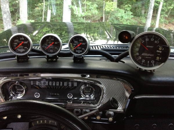

who did the dash/cluster?
